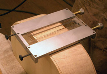

I do it off the guitar on non cutaway instruments on the table saw as shown
on my web site. I rout a solid block in the guitar on cutaway instruments in
order to insure that the edge of the neck and cutaway are in exactly the
same plane and the neck is exactly centered on the top.

I do mine after the box is together and the binding is on.
I use my endgraft/edge vice from Chris at Luthiers tools
I have 2 templates for this vice. One for my endgraft and one for the neck mortice.
